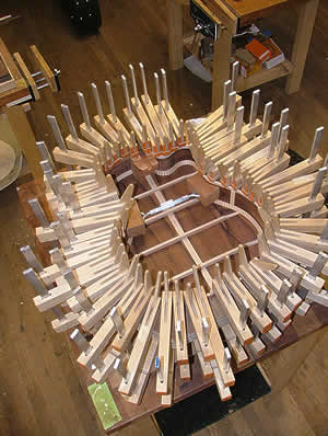

   Darn, I hate posting twice in a row, but I'm just reminded about cam-clamps.
   One, they are most excellent, like Mattia's already stated. I'll just add to this. Do not get the Stew-Mac cam-clamps! They use a sort of seration on the aluminium rod, and someone correct me if I'm wrong, but those suckers are a real pain to open up after clamping... At first I though it was just me, but then I got some Klemsia clamps from Lee Valley and I couldn't believe the difference. The ease in operation is just night and day (although you will need the Stew-Mac ones if you want the 8 inch reach). Hope this helps.
PostPosted: Wed Jan 18, 2006 6:55 am
[QUOTE=Alain Desforges]    Darn, I hate posting twice in a row, but I'm just reminded about cam-clamps.
   One, they are most excellent, like Mattia's already stated. I'll just add to this. Do not get the Stew-Mac cam-clamps! They use a sort of seration on the aluminium rod, and someone correct me if I'm wrong, but those suckers are a real pain to open up after clamping... At first I though it was just me, but then I got some Klemsia clamps from Lee Valley and I couldn't believe the difference. The ease in operation is just night and day (although you will need the Stew-Mac ones if you want the 8 inch reach). Hope this helps.[/QUOTE]
I have the StewMac clamps and I love them. Only a couple of them have gotten stuck and a good swift whack on the concrete floor usually opens them right up. No problem.
I don't think they are aluminum, but I wish they were. Aluminum clamps cut down on the weight, so glued up rims are much easier to set aside.

Wow Brock, at 15 bucks a pop, I can see you have quite an investment just in your clamps!!!
I don't know then but I have 4 from Stew-Mac and every time I clamp something with them, I have to fight to get them opened up, effectively having to revert to just pulling on them still clampled to whatever item I'm gluing up or fastening to a bench or what have you... I guess I'm just unlucky or they've changed their desing...

[QUOTE=Alain Desforges]   Wow Brock, at 15 bucks a pop, I can see you have quite an investment just in your clamps!!!
I don't know then but I have 4 from Stew-Mac and every time I clamp something with them, I have to fight to get them opened up, effectively having to revert to just pulling on them still clampled to whatever item I'm gluing up or fastening to a bench or what have you... I guess I'm just unlucky or they've changed their desing... [/QUOTE]
Mine "hang" under my small work bench in the open position -- small ones on one side, big ones on the other. When I need them I simply grab them, flip them and gravity does all the work. Don't store them closed, it makes clamp up too hard.

The point is you can get by on the cheap if you need to. John How's list looks pretty good. Klemsia clamps are a must. I still only have four of each size. Other clamps can be had pretty cheap at Harbor Frieght, or Costco. You can never have too many clamps. I bought a bunch of old files and rasps at the flea market. I bought (quality) planes off of Ebay.

You know, that's the first time I've seen a whole herd of cam clamps at the same time.

Brock, I've never seen so many Klemmsia Klamps in one place. Hey guys, we've overloaded him I'm afraid. That's why building your first in a class is so nice, others have the needed tools.

Again, can you believe all of Brock's Cam Clamps! Me jealous! I have sixteen and want'um more.

[QUOTE=Dickey] Brock, I've never seen so many Klemmsia Klamps in one place.
Again, can you believe all of Brock's Cam Clamps! Me jealous! I have sixteen and want'um more.[/QUOTE]
Yeah, I know.... I have a weakness for cam clamps. They are just so perfect for everything. I have them hanging under every bench I have in multiple sizes. Not a day goes by that I don't use them to clamp something up, and I find they make a good 3rd hand too.
